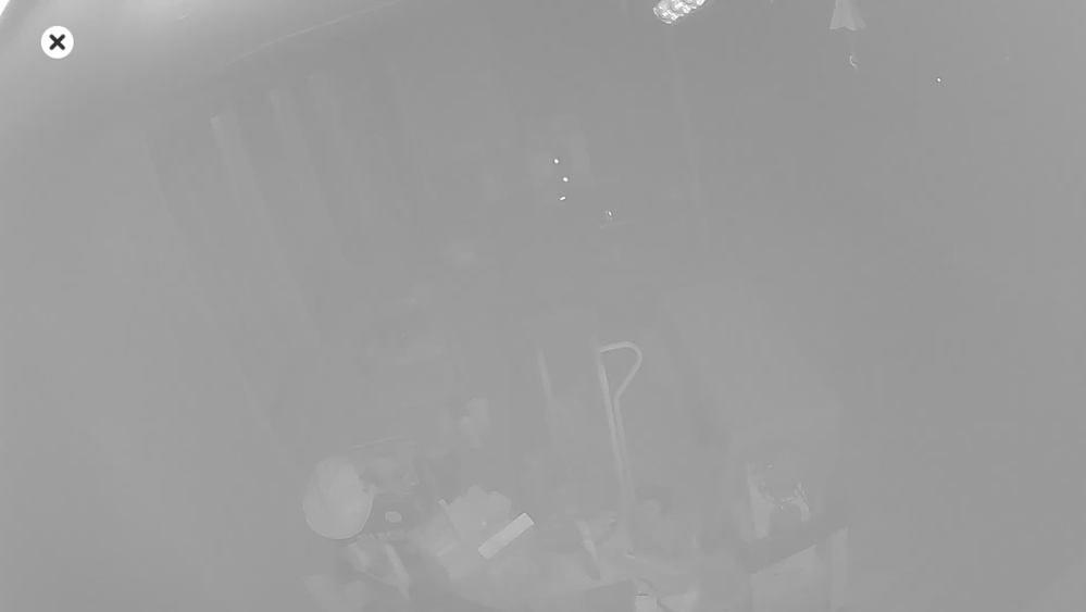

Loubob
This image is looking at my back deck. You can barely make out the handle of a furniture dolly about 6’ in front of the camera. Worthless! The other camera in our driveway barely picks up the reflective license plates on the vehicles - no chance of facial recognition let alone detecting color of clothing if a person were to trigger it. Did I mention Worthless?

AmericanZulu
There is a clear plastic protective film on the front of the cameras when you unpack them. If you didn’t peel that off, then the infrared LED lights would probably reflect off of that and render your nighttime image hazy and overexposed, much like the image you shared. Try peeling those off and see if things don’t improve.

Something is definitely wrong with the camera image that you posted the nightvision image for.  I haven't seen anything like that from any of my own cameras.
Some of the skins can also interfere with Nightvision.  But of course it could easily be a defective camera.
mchromiec
The milky colour you are getting looks the same to my camera when i have it seating to close to an edge of some sort. I found the infrared light to be reflecting somehow. Try moving the camera a little and see if that helps. I personally have purchased infrared flood light of ebay to help with the lighting at night.

I think that's a good idea if you have one, though I am still thinking something else is going on with the one on the deck.  I'd try swapping that camera with one of the other two.
