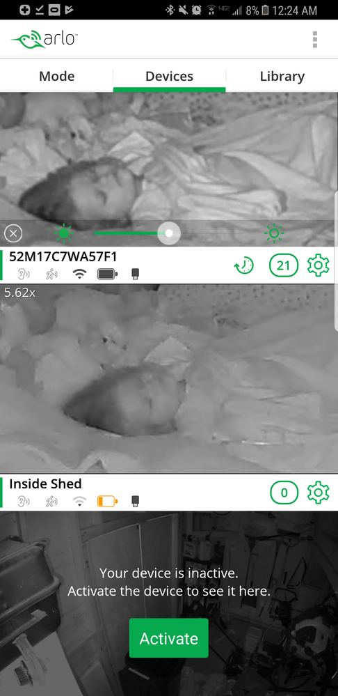

Turned brightness up and down - no effect.
Then on front camera turned off night vision - awesome miles better than Pro 1.
Then rear camera, tried turning off night vision disaster all black.
Is there something different in night mode Pro 1 vs Pro 2.
