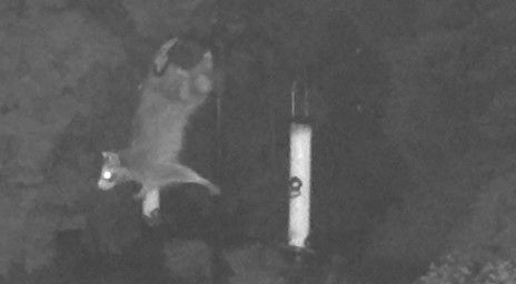

jakeman35
Attached is the pictire of racoon I recorded manually.
