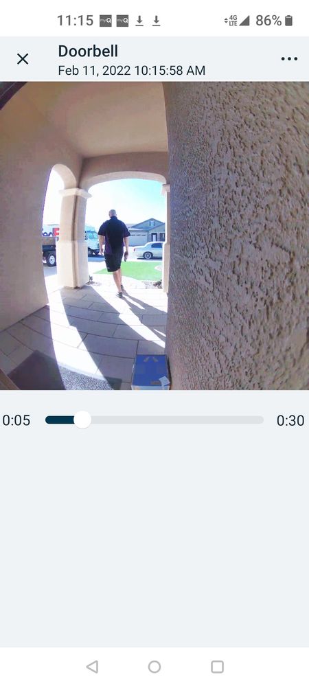

I have my essential wire free doorbell set for package detection. I've had several packages delivered over the past three weeks. Not once has it reported a package detection. It reports a person. Here is a screenshot of a large package that was delivered yesterday.

Here is a screenshot of a small package that was delivered today. Same thing. It reports a person not a package.

The first is FedEx. The problem here is the doorbell had a delayed trigger. The next two are of me. One caught the package the other didn't. The other was most obvious, I'm holding it in plain view to my side.
This is a FedEx delivery. The problem here, as you will see, is that the person isn't caught farther away. I have tested my sensitivity and it works best at 100 and only catches the approach with five to six feet most of the time or like the FedEx guy, right at the door.

Just for reference, the package detection feature is designed to work when the Arlo camera sees a package being picked up or dropped off, placed within frame. I can see the 3rd video, the box was placed within the frame. Was the 3rd video successfully detected as a package? If you like, possibly creating a drop off spot for your packages within Frame will allow the packages being successfully detected.
That being said, the Arlo Team is still investigating since the camera missed that larger package from UPS. You can find more info here if you would lie to check out further details regarding the package detection feature. What is the Arlo package detection feature?
