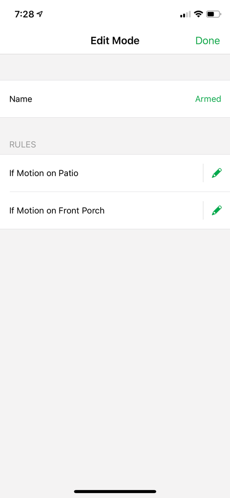

So when I set up my base station, I also set up to Arlo pro 2’s at the time. ( Front porch and patio )
I have since added one Arlo pro 2 to that base Station For a total of three cameras.
Without creating a new custom mode, there is no way to add this new camera to the armed mode. Am I correct? What gives?
If I reset my base station could I have access to all three cameras in my armed mode ?
The Armed mode should automatically get all cameras in there. It's custom modes that you have to manually add cameras. Try rebooting the base and then removing the new camera and resyncing it. If that doesn't work, a system reset may be needed.
2 REPLIES 2
Removing the new camera first, then rebooting the base station and then re-adding the new camera worked.
