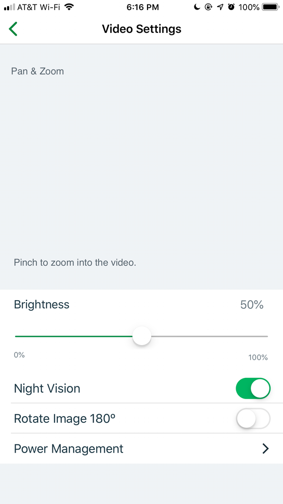

Use of a browser works fine but for the apps right now use the Video Settings for the camera and use the Invert selection twice.
The invert selection button is gone after app update, so I guess I have to wait for the new updates, it mean time, use the browser to change the still image for activity.
It's still there, just not Invert. It's Rotate Image 180.
Yeah it does work with rotate image 180. initially it did not work as the it would not connect, so it crashed. and it could not work it with double click
To make it work, have to go to video setting, click on rotate image 180 green, then get out, what it does it refresh the image, then go to activity zones, hopefully it will refresh the image, but flip upside down. press save, dont make new activity zone,
then go back out to video setting, click on rotate image 180 so is not green, then get out, what it does it refresh the image back to normal angle, then go to activity zones, hopefully it will refresh the image by flipping upside down -180. press save, now u have new image in right way, can now make new activity zone.

You can also use the web interface or go to the camera video settings and rotate the image twice.
