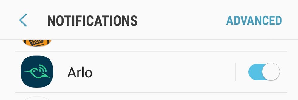

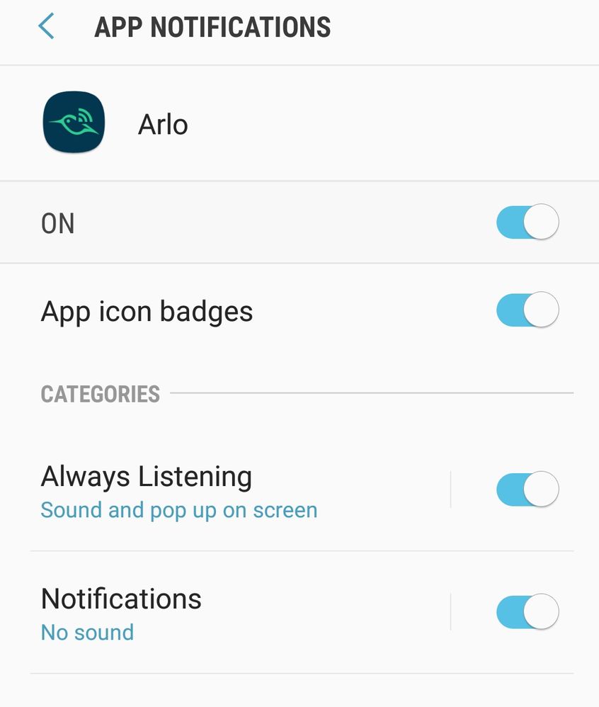

So, I haven't received "pop-up" notifications on my phone since the new set up(new base/cameras) has been used, which was yesterday afternoon. I've set them both on my phone and the arlo app, but nothing. The emails come through but would be nice to have the pop ups as well.
