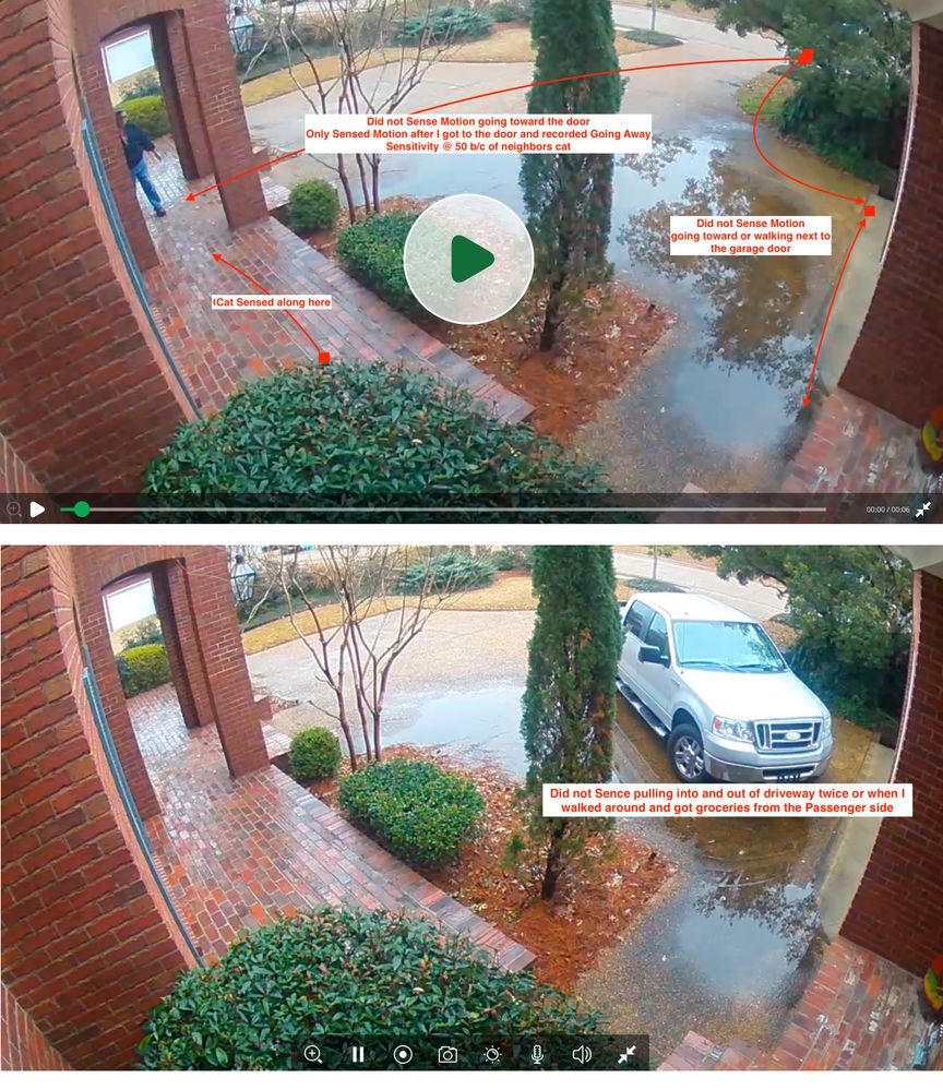

Please see Attached Photo 1. I solved my scheduling issues and that is working as expected.
My outdoor camera is not detecting motion properly. As indicated, I set the sensitivity to 50 b/c the neighbors cat is moving around our house but the camera is not even detecting my truck. I suspect the issue it the camera is detecting motion from the various trees and blocking out thise zones. If that is the case, how can I properly get motion detection with the camera in this location or do I need to move it. I guess I have to do 2 posts to get two photos attached

Only one post, photoshopped 2 pics into one

I turned my phone off, then:
1. Pulled into the driveway then back out into the street out of sight of the camera, no detect.
2. Walked to the front door then away. This is the only point where there was a detect, and it was when I got right next to the door (you can know this looking at the time bar, b/c the recoding starts when I'm already at the door), then it recorded as I walked away.
3. I walked in the driveway, along the garage door toward the camera then back into the driveway and to the street-No Detect
4. Pulled the truck into the driveway got stuff out of the passenger side, walked to the front door and entered, No Detect.
5. Entered the foyer and then around the den, Inside camera detected all movement.
Therefore I know the geofence, schedule and modes are working properly as I did get the 1 detect outside and several inside.
I have tried motion testing, the LED is rather hard to see in the daylight but I was getting similar results, for example motion was not detected near my truck. I just didn't trust the results so I did the real life test above.

So I reset the sensitivity to 90 and tried my test again. Looking at the infrared camera energizing, the results show it's clear that the tree next to the garage and the one in the middle of the frame are creating zones where the camera will not detect motion. Watching the game, drinking wine and contemplating the state of the world, it occured to me that this siuff is really hard and my situation is such that I can move the camera into the garage to accomplish what I am trying to do.
