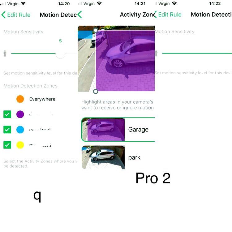

I have an Arlo Q and now a new Alro Pro 2 I was setting up active zones the same way I did for the Q. However when I want to select the active zones I want the Arlo Pro 2 to record on it does not locate them. The process is the same as for the Q right? Please see photos attached.

It's been a while since I used zones on my currently deactivated Q but the current scheme is that any zones set are automatically used by the wireless cameras. You can't select which ones to use. I remember that the Q allowed you to choose which zones to use - if that's still available then the wireless cameras act differently.

The functionality should be the same. The difference would be whether you can set camera rules to use only certain zones or if you're forced to use them all since you can't select them.
Arlo pro 2 has exact same setup rules (I.e 3 zones) but is near enough useless in practice as it uses both frame by frame and heat sensitivity..that is to reduce number of false positives...I want the option to choose best method for my arlo pro 2. I would choose frame by frame because a lot of activity I am concerned with is outside the ability of the sensor to detect heat.

The Pro 2 manual talks only of activity zones.
You can identify zones within the camera view where you want the camera to
detect motion. These zones are called activity zones. You can also select which
activity zone or zones detect motion.
No mention of "inactivity zones".

No such thing as selecting a zone to ignore. You select zones to monitor and that left unselected is to be ignored.
