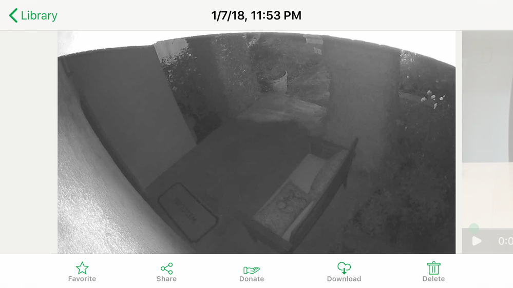

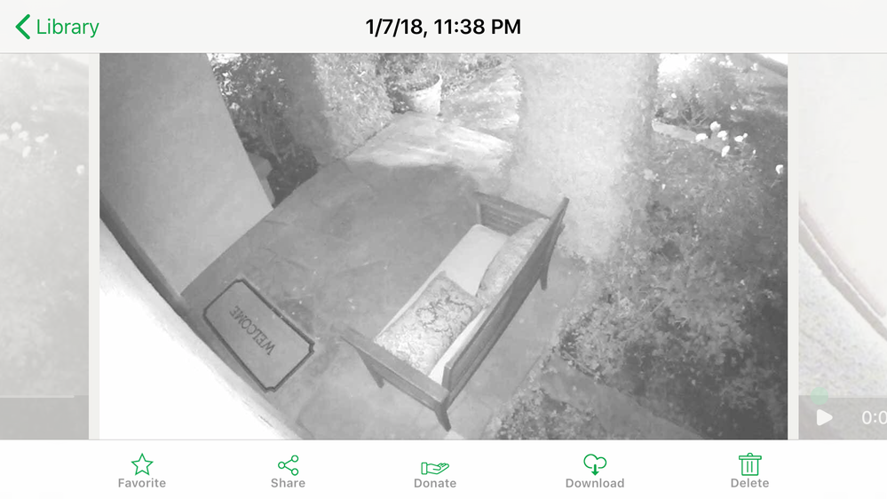

- no, I took the protective film off the screen
- no, there isn’t a hood on the camera.
- yes, I tried swapping the cameras out and t made no difference
- yes, I tried uninstalling and reinstalling the camera and it made no difference.
- yes, I returned and repurchased new cameras and it made no difference.
- yes, I installed the firmware updates and it made no difference
- yes, the Arlo Pro 1 was in the identical same mounting/lighting situation when hear two comparison images were taken.
Hopefully now we can move beyond these and get someone at Netgear to actually address if this is a defect in the product and how they’ll remedy it.
