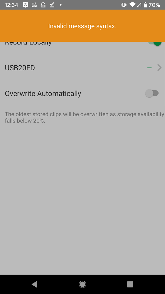

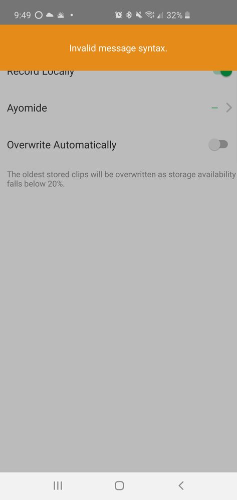

Invalid message syntax - Using USB - when formatting or enabling local recording. See screenshot.
I am getting "invalid message syntax" error whenever I try to do anything on the USB drive. Either formatting or trying to enable local recording. I get this error as long as I am dealing with the USB drive.
I have tried 3 different USB drives now. Same error message.

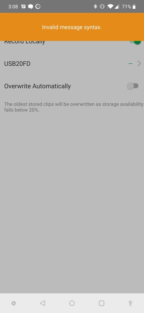

Starting a new thread on this topic. The previous thread is closed and no solution seems to have ever been found. In short, my overwrite function for an external USB drive has never worked and now I get a "message syntax" error when trying to enable it. Has anyone found a solution to this bug?
App version is 2.12.3_27015
Android App
Android App

Yes, I just uninstalled the Android app and reinstalled it. No change. Using a OnePlus 7Pro running Android 10. I have 6 Arlo Pro 2 cameras installed and a 128GB thumb drive connected. Over the past couple years I've never successfully had the thumb drive overwrite once it reaches capacity. I was hoping this had finally been resolved but I guess not.

Same issue.
After toggling off the overwrite setting, I can no longer change USB options and the USB drive no longer registers itself correctly.
Attached error occurs when attempting to toggle on the overwrite setting and the Record locally setting.
