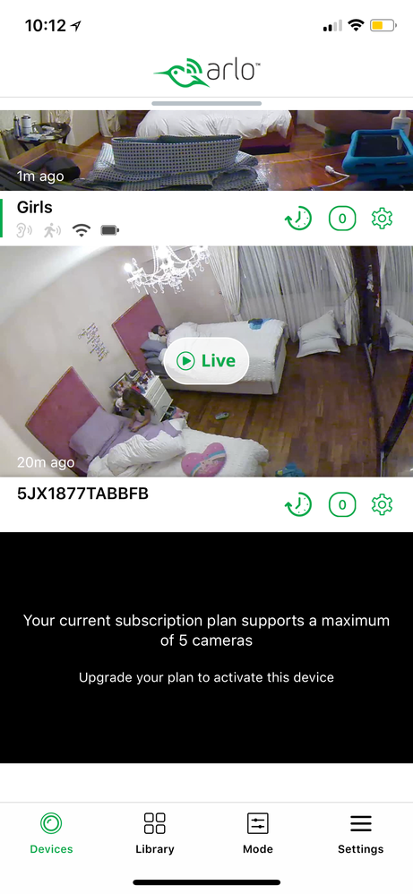

I don't know what code you are talking about. I purchased the 6th camera outfit, on a new account and
1. there is no ask for a code
2. I can't add the 6th camera
3. when I called to speak to Netgear tech support, Anthony stated "you are only allowed to add 5 cameras" on base station even though the kit is a 6 camera kit.

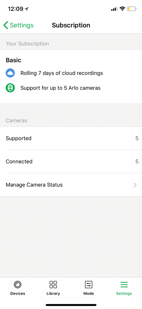

Does not let me change subscription. Does not let me see all 6 at same time.
Have to deactivate one in order to see 5
You didn't install according to the instructions that came with the system. You have to select the specifc model/SKU/whatever to get the 6 camera setup. This only works for a new setup so delete everything in Settings, My Devices in your current login and start fresh with a different email address.
I put a new email. Tried to set up the 6 cams. And nothing
I can’t change subscription also
