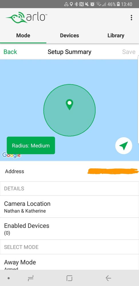

Would like to know if there any issues with the acquiring location. When I go into the app and edit the geofencing location it always put me in NFLD when I am in Ontario. See picture. It used to work fine before the updated app.

As soon as I click the arrow in the bottom right hand corner it find my location. The circle does not indicate my radius around my address.
If I enter my address manually it gives me an "Failed to discover location for given address".

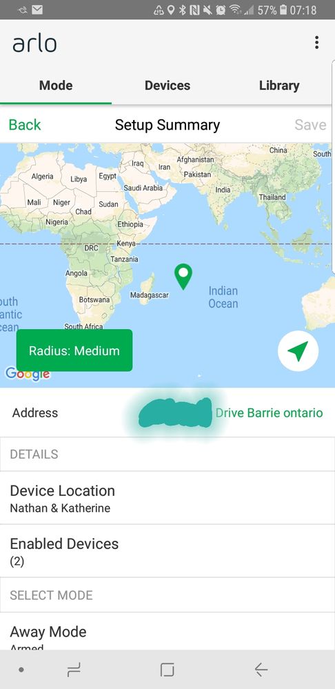

When I set my home location in the app, is fails to detect, so I manually save it. Every time I open geofencing the app thinks I'm in the middle of the ocean. I click on the location icon and it zips over to my actual location. Because thinks I'm in the middle of the ocean, the app is always set to AWAY mode - which is not true.

Same problem here. Shows i am in Southern Africa. Can click on arrow, and it finds the correct place and then click save. Next time its back in Africa. If i try manual, it fails to find location for given adress. Real bummer, if geofencing dosent work, this system is going back to the dealer.
ChristianDK
Got it working 😁 Push the arrow to find yourself, then zoom in with 2 fingers on the map. Now you can type the adress, and it will find you. So, just zoom in with 2 fingers was the solution. Strange its not explainded anyware i manuals, that you med to be zommed totaly in before the adress typing.

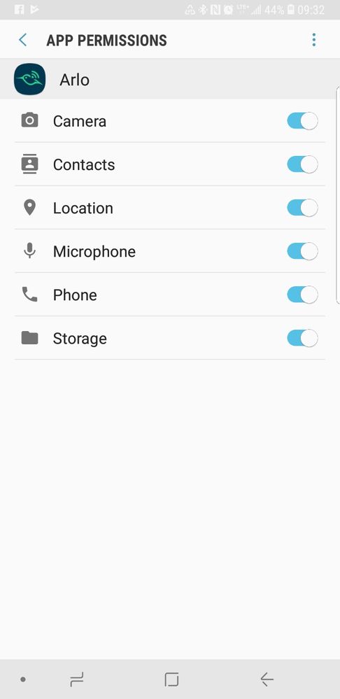

Just to make sure, did you make sure that you gave permission to the Arlo app to detect your location? I would suggest to try disabling and re-enabling the location permission through your phone settings to see if that helps.
Clue2198
They are all enabled.
Not sure why the app requires some of these permissions

When I turn on geofencing it shows me in the middle of the Indian Ocean with the green circle around it. I press the arrow it finds me. I enter my address. It cannot located the address.
