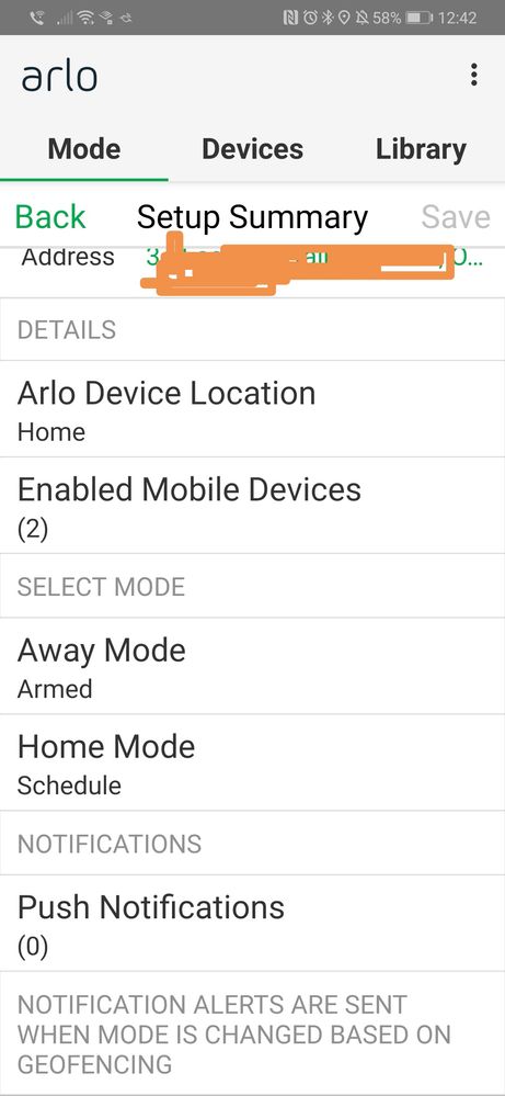

@Phoney49 wrote:
I looked on the Android app, and their is a Notifications option...
Where are you looking?
Just another user
@michaelkenward In modes under geofencing. It looks just like devices, but it says Notification
That is part of the mode setting for Geofencing. It sets which mobile device receives alerts.
Just another user
