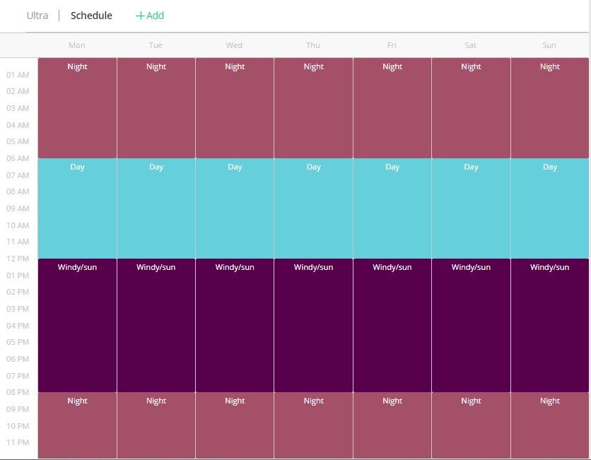

To save on the number of screenshots I'd need to post, here's one of my schedule. The main difference is that the Day mode has motion detection settings for a few cameras of 60 while Windy/sun has settings of 35. The Night mode has settings of 70.
