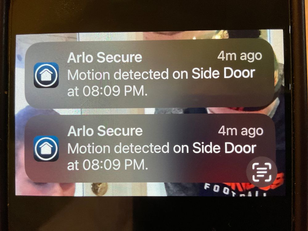

I’m not sure how I could provide such a screenshot. I get an audio notification with a banner. Then I get a second one about 5 seconds later.
Ok. Here’s a screenshot after both notifications hit. Hopefully you can see it; it looks blank on my webpage but I’ve tried posting it five times.

The reason I am asking about this setting is that we've seen the double-notification issue in the past. Generally it has been with cameras that are using this setting. Changing the recording to fixed length has generally worked around the problem.
Are you just getting double-notifications? Or are you seeing two identical recordings in the Feed/Library?
Just one recording but two notifications.

I think the issue is in some cases linked to the smart notifications. There is lag in the classification (partly due to the time it takes the cloud to classify, and partly because the object being classified might not be in the field of view at the beginning of the recording). If Arlo delays the smart notification too long, then people complain about the lag. So it does make some sense for them to send a second notification that is updated with the classification.
So another experiment you could do is disable smart notifications, and see if that makes any difference.
Experiencing the same results now since last update on events on all Pro 4 cameras and when Mode changes occur.
Disabling the smart notifications did not affect the behavior. Still getting double alerts about half the time, from all cameras.
