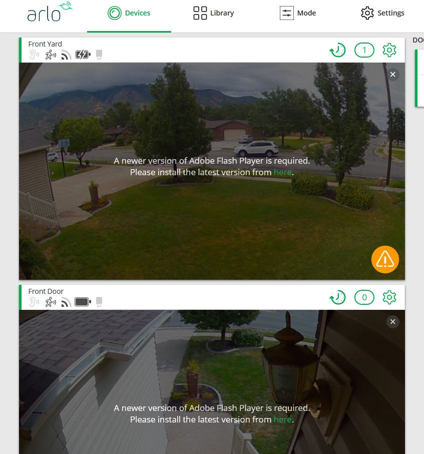

Did something change on the Arlo Portal?
I can no longer view my live cameras on my desktop computer. Everytime I click on the "Live" icon to watch a camera, I get the message "A newer version of Adobe Flash Player is required. Please install the latest version from here."
I go through all the steps and download the newest version, and restart my computer, but I keep getting the same message.
I also noticed that when I log in to the Arlo portal, it no longer asks if I want to choose "Remember me".
I can watch it fine on my android phone, but on my computer, no luck.
See enclosed screen shot.
So, to sum it up, I have the latest Adobe Flash player, why won't Arlo allow me to view it live?
For those that have this "Flash" issue:
Click on this icon in address bar:
Choose "Allow":

After you get the error, you should see a "lego" icon to the left of the padlock in the address bar. Click on that, and you can allow flash. Finally, get rid of the update flash error by clicking on the "x" in the video preview, and press Live again.

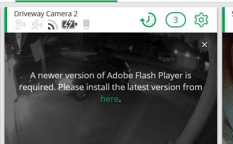

I have 4 Arlo Pro 2 cameras around the house. I check the video streams every day using my Firefox broswer. Recently I cannot check the live stream and get the following message:
I go to the link and download and install the latest Flash player. I restart the browser. However, I STILL cannot stream and get the same message again. I check my browser settings and, yep, I HAVE the latest Flash player. I decide to try to Chrome browser instead. It's the same thing. So, for the last week or so, I have never been able to check the live streams of my cameras. What's going on? I HAVE the lastest Flash Player installed. I have no idea what else I can possibly do. I used to be able to check live streams every day. Thanks in advance for your help.
With firefox, click on "live" and get the error. Then click on the lego icon (the post right above yours has a picture) and allow flash.
After that, click on the "x" above the error to dismiss it. Live will then work correctly.
With Chrome it's similar. But you click on the padlock instead of the "lego".
