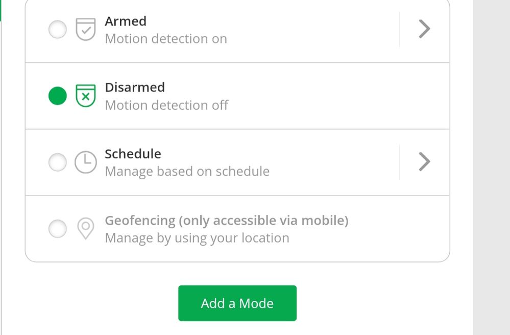

Same issue - even logging into the website - the "disarmed" setting is grey'd out - it keeps you in "armed" which does not have a setting to turn off emails. I'm getting hundreds of emails.

This Arlo affair seems to be a total mess. The base station is stuck in 'getting information' for two days now (which is the total number of days I have the system installed) which means I cannot change the notification emails which are driving me crazy. And yes, I tried to change it online on the website, and it looks as I did but in two seconds the selection goes back to where it was and the flow of emails is drowning me. I'm desperately trying to use the chat option and I cannot. It looks fine but when i click 'continue' nothing comes up. Is life with Arlo this complicated?
