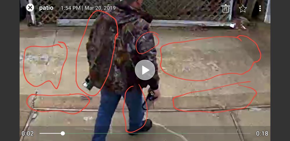

I've had this base and 5 camera's for 3 months, and I think my base might be bad?
My camera's are constantly showing blocky video on and off while watching the clips.
