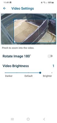

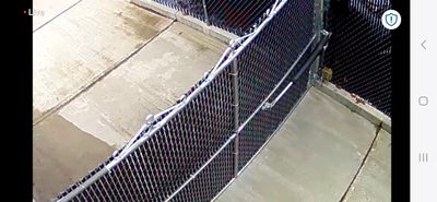

This is another setup. See pictures
1. Video settings view
2.after live view. Already know is not working because live view should be what I did set in Video settings.
first picture live view after setting. Second picture video setting.

Set video all the way to right corner. In zones did nothing.
In live shows mostly I like. And manual recording shows ok.
