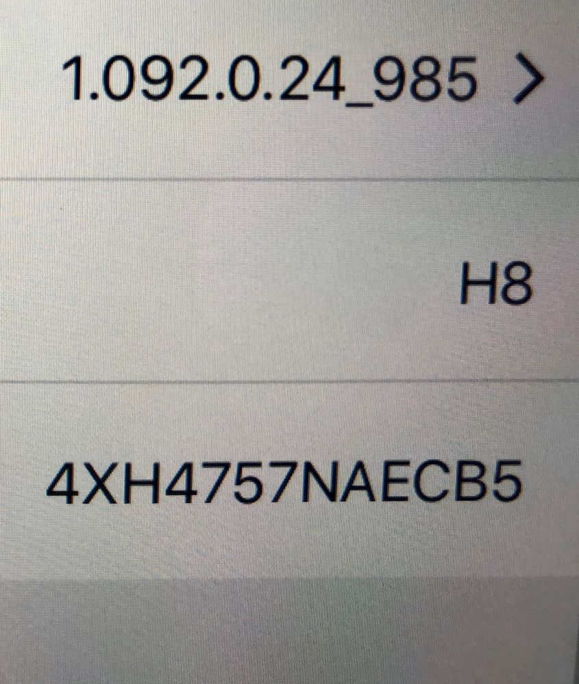

this is my firmware, it’s not the same as my other cameras? No update available
