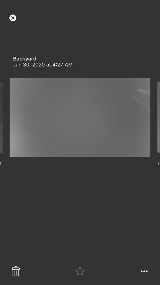

Here is the camera at night and the IR light is on.

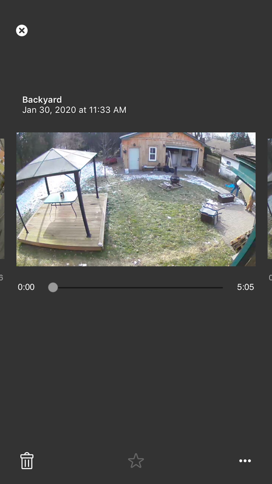

Here the same camera during the day.
Message 4 of 6
1,815
Well, definitely not a nearby object. I believe the issue is the distance - the IR LEDs won't light up large areas. There may also be dew on the lens exacerbating the issue. What happens if you turn on any outdoor lights and record?
Message 5 of 6
1,739
We actually pulled our silicone skin off of it and it is now working great! Problem solved!
