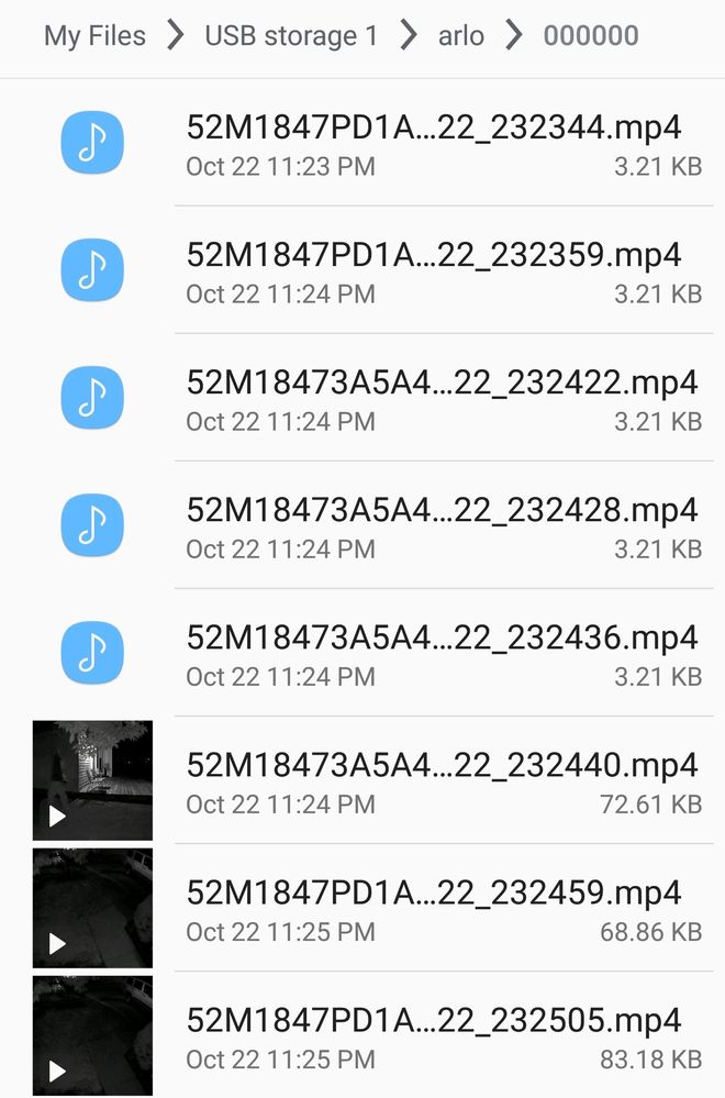

I just did some testing on my two Pro 2 cameras and the 8 gig USB thumb drive for storing videos locally to make sure it was working and it's not.
So when I have a internet connection everything works fine. The videos get uploaded to the web and the video gets saved to the USB drive in full. I can replay the USB videos via VLC player perfectly.
The USB stops working as soon as I cut the internet connection to see how the system performs when the internet is not available.
When I test the cameras when there is no internet connection at night time outside I can see the infered LEDs light up when I am In view of the camera but they do not stay illuminated, you can see the red LEDs turning On for a few seconds and the OFF, and then they will turn on again and turn off again.
It keeps doing this when I am in view of the camera. When the net is available the camera detects me and the IR lights stay on the whole time I'm in front of the camera and only turn off when I'm out of view.
When I go back and look at the USB video files for recordings when the net is not available what I find are tons of small .mp4 files that do not play in VLC because they are so small there is no data there or there will be short video clips they play but never the whole recording that you would normally get if the I internet was available.
I attached a screenshot of the small video files that are saved.
When the net is available the video files are full size and the video files play without any problems so I know the USB drive is working fine.
So you may be relying on the USB drive to save your video files when the internet is down but you need to verify this because it may not be actually working when your internet connection goes down.
I'm running off a mobile 4G WIfI hotspot with unlimited data on my phone. When I leave with my phone the camera is without a internet connection. It would be nice to know Arlo is actually recording to the USB drive in case something did happen while the internet was not available. Right now that's not working correctly.
Is anybody else seeing this same behavior? Better check if your relying on this feature and check back here so we know if it's a wider spread problem.
I did reset the base station before the testing just incase that would have helped.
