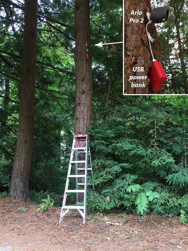

I have an Arlo Pro 2 camera up in a tree. Every week I have to carry a ladder to the tree and climb it, to recharge/exchange the 2,440 mAh Arlo battery. This is a little dangerous to do every week, and my wife cannot do this. I want to power it with a larger battery such as a 26,800 mAh battery, then I must climb the ladder only once in 10 weeks.
I've included an image of my camera placement and a USB power bank attached with a USB cable. As you can see there is no sunlight for a Solar panel.
1) Can I use a "USB power bank" plugged into the USB port to power the Arlo pro2 ?
2) WIll the Arlo Pro 2 then operate continuously for appx 10x as long as on the 2,440 mAh battery?

That red USB battery is about 5,000mAh. 26,800mAh battery is not so big, about 4x the size of an iPhone.
I will paint the battery brown and hide it on the backside of the tree in some kind of water resistant enclosure.
Another thing I'd prefer to avoid is moving the camera, because it takes some effort to re-aim it each time, and I don't have wi-fi at the camera location. Other than that, its working good (as in the pic) just need more battery power.

Again, here is the same "example pic" of my proposal.
And this is what's happening. The Arlo Pro 2 is connected to the USB power bank, and the internal battery is depleting (now 3%). Will it deplete to 0 % then access the external supply?
I'm mainly looking for confirmation that the camera will "operate normally" powered by a "USB battery bank". I can imagine a situation where the camera declines to ask for external power until it's internal battery is dead. Or perhaps the Pro 2 NEVER accepts external power without "a handshake from an approved power supply".

In my pic, the red 5000mAh powerbank has been connected to the camera for a few days, and the camera battery has depleted to 1%.
The Arlo Pro 2 camera went off-line with USB power available.
It seems that the Arlo is NOT drawing 5v from the USB microprocessor-controlled powerbank.
So TomMac, I think you're saying it DOES work with a direct 5v source, i.e. "not microprocessor-controlled 5v".
