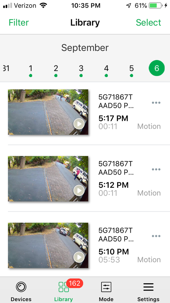

Have Arlo Pro 2 set for 30 second clips and getting random clips from 3 seconds to over 5 minutes. Seems to miss action between also.

Noticing on some short (cut) clips on playback, the video will play the few seconds (on short clips) and the audio will play the set time. (On some) Others will be just short.

I added a Pro 2 to my three-camera Pro system in late August and have the exact same problem, it's only with the Pro 2 camera when it's on AC power.  I've tracked the recordings for 12 days now.  About three percent of the recordings freeze the video (but not audio) at around 11 seconds.  Twenty percent record for random lengths, usually shorter than the defined 120 seconds at which they are set.  I've done all the power cycling, removed cameras and re-synced, removed and re-inserted the battery.  Still continues.
