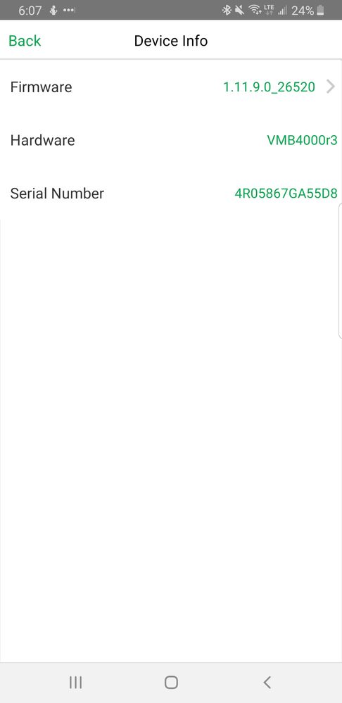

camera firmware 1.125.11.3_26229
hub firmware 1.11.9.0_26520

It looks like your base station is a few firmware versions behind & the Camera is one behind. Can you update to the latest versions &  test the Push To Talk Feature again. I have added the links to the Firmware versions and their notes below.
this is the same firmware that I show today, with no updates available.   Was there a mistake when someone told me that my firmware was a couple behind?
You can always use the Release Notes area here to check your firmware versions. Your base is on old firmware - here's the latest:
https://community.arlo.com/t5/Firmware-Release-Notes/Arlo-Base-Station-VMB3000-VMB4000-1-12-0-1-2794...
Same for the camera:
https://community.arlo.com/t5/Firmware-Release-Notes/Arlo-Pro-2-1-125-11-4-29092-4th-January-2019/m-...
If rebooting the base doesn' offer you updates, you may need to reset and start fresh to clear out weirdnesses.

After resetting the base station, the cameras and the doorbell, I am currently on firmware 1.12.0.1_27940 (base station)
Cameras are on 1.125.11.4_29092
Doorbell is on 1.2.0.0_297_268
