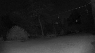

Wanted to update everyone to let them know I did purchase the 4 camera Arlo Pro 2 set this last weekend and got the cameras installed. Here are some samples from around my house.
Front Daytime
Kitchen Night
Side Night
Back of house night
Front Night
I don't really have a previous setup to compare with but I did want to show some examples. This is on the optimized setting on all cameras.

I too (like many) have an issue with night time poor quality !! They sent an email out a couple of days ago, advising there will be a firmware upgrade, BUT... failed to mention what the upgrade fixes!! (Great communicators).
Your kitchen side night is the only decent view IMO. Do you have external lighting there or its it just the cam's IR? What brightness level do you have the cams set to?

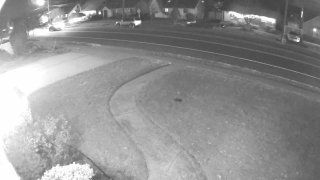

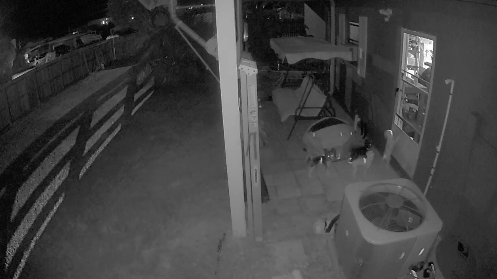

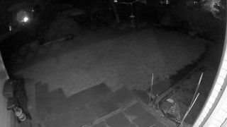

Ok, i have removed the "hoods" and the night vision has improved for me. Ive went the hard route and actually power wired the front cameras so i can get the 3 second look back. Thoughts on the quality? Im a little less satified with the back fdoor camera. Backyard (most problem plagued)
Front Driveway

Front Stairs
No external lights and the brightness on all of them are the default settings.
IMO removal of the hoods made the quality acceptable. I concur the back door view could be improved but you may also want to put a motion light there (non NG is better). If you prefer get a wide able IR illuminator. The cam reflects off which surfaces, especially white ones, and that post as small as it is is centered to your cam view. IMO if you move it you might get some improvement and may not need all the external lighting and IR.
