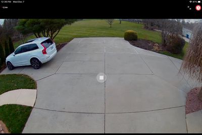

Then it sounds like camera positioning and/or motion sensitivity setting in your modes and rules. Try reducing the sensitivity in the (various) camera rules and post a screenshot of the cameras' views for suggestions.
Attached is a snapshot of the driveway cam and its sensitivity setting. I change the setting to 50%. There are no rules or activity zones set up for either camera.
Actually you haven't. You are using the motion detection test - the threshold there is only for the test.
To change it for real, you need to go into the camera rules.
Wrong pics sent. Here is the sensitivity settings. Was 80, adjusted to 50.
