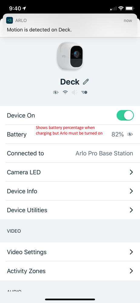

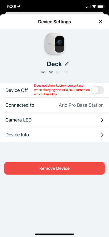

I have attached a screenshot of when the Arlo is off and charging, it does not show the battery percentage which doesn't let us know when it is fully charged.
When the Arlo is on and charging, it does show the battery percentage but it defeats the purpose as when I charge, I rather have the Arlo off so that it charges quicker.

That is the issue I am trying to solve. Before, when it was charging and turned off, it would show the battery percentage so you know when it is fully charged. Now, when it is charging and turned off, it DOES NOT show the battery percentage.
Attached is a screenshot of the Arlo charging and turned on, it shows the battery percentage but my issue is that in the past it showed the battery percentage when the Arlo is charging and turned OFF.
