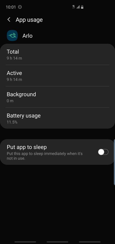

Samsung Galaxy S10+ (T-Mobile) android application issue. The application drains battery way more than it should. Looking at battery usage it is showing Arlo as active the entire time not running in the background. I only had the app open for all of 5 minutes but it showed Arlo active for 10 hours with 12% battery usage. It wasn't t even open in task manager so the application is just glitched. For now I'm forcing the application to go to sleep any time it's not open to prevent this. This negatively effects the Geofencing option for my Arlo though as I manually have to open the app to get it to see I'm not home.

I can report I have the same exact problem. Battery usage is ridiculous and shows app is active all the time and 0 minutes in background.

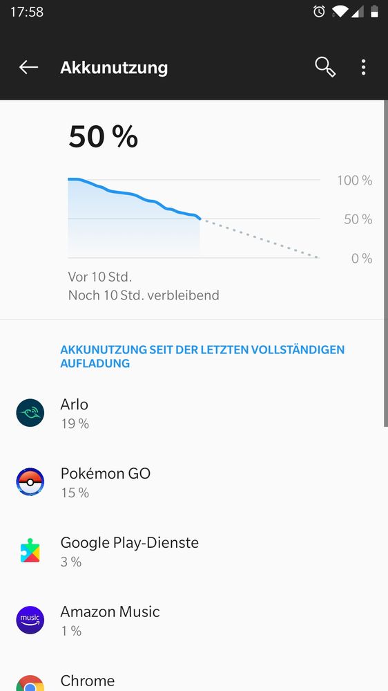

I have read through the troubleshooting sections of the Arlo website and found nothing relevant. I took your advice and rebooted the Arlo base station yesterday evening. I also rebooted my phone. It did not help. Please see the uploaded screenshot. The Arlo app used 19 % of my battery in just half a day while staying in the background with geofencing turned on.
