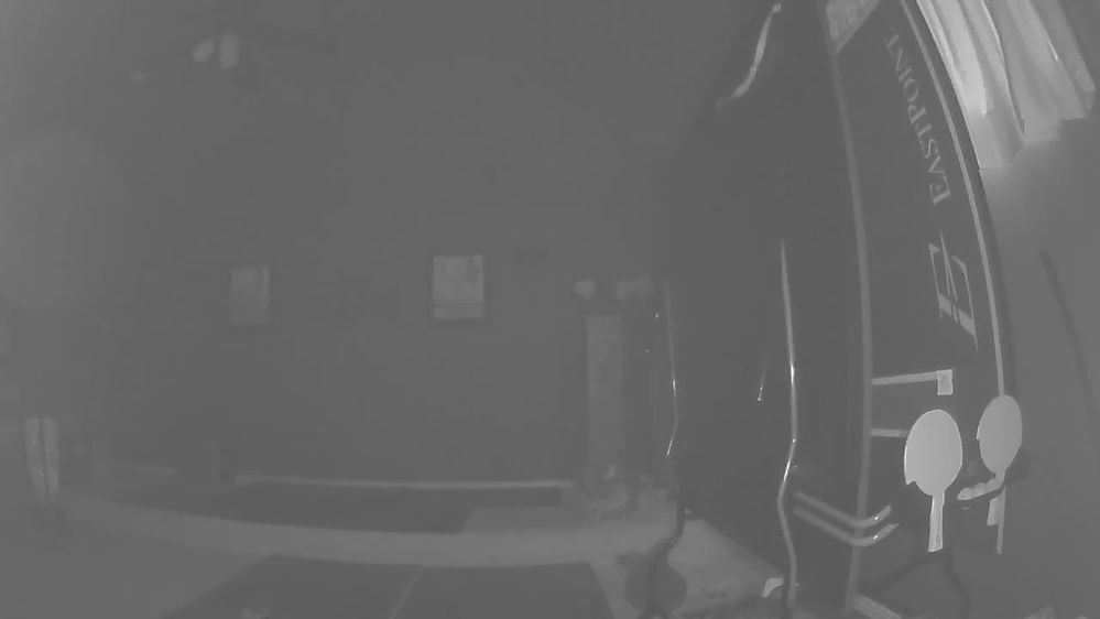

Take a look at my view last night through the camera.... This is what Netgear considers "NIGHT VISION", it was raining last night but that isnt an excuse as my driveway arlo pro 2 did not look this bad last night, and through hail sleet and snow my Arlo Pro 1 never looked like this.... its sad...My night vision view last night

I've pulled some images from other threads. While people are resolving their issues of grainy nightvision video by removing their skins, the other issue to still note is what's shown above. The Pro 2 nightvision overall is darker than the Pro nightvision.
I have been playing around with one camera and it seems that if you place it in an area where there is absolute darkness or does not have any object/wall around for any reflection from the IR night vision, the video quality does seem to be working fine. Again, this does not apply to a real world scenario which makes it useless if you can't get it to work like the original Arlo Pro where these are factor in.
