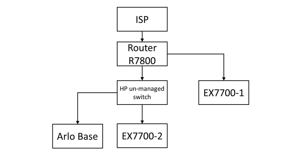

Turn out it may worked out. So far my cam run for 4 days without happen again. I will mark this as solution if it can run though a week. My network environment is enclosed. My problem may cause by multiple reason:
1. The base station is placed next to one of the EX7700.
2. Wifi Channel conflict
3. Mac Filter for WiFi access control
I have tried the below so far:
1. Restart the base: Result=> it happens after 1 day again
2. Reset the base and sync everything back: Result=> it happens after 1 day again
3. RMA to Netgear: Result=> does not find any issue for a week running test there)
4. Turn off 2.4Ghz WiFi from EX7700: Result=> it can last for over 1 days
5. Turn off Mac Filter & 2.4Ghz WiFi from EX7700: Result => it can last for 3 days
6. Reset factory setting of the router and make the setup with point 4 & 5: Result => it run for 4 days and still running OK.
hopefully this is my solution.

4. Connect the base to a unmanaged switch or direct connect to my router.
The base always glowing blue in color, so I assume it is working normal. But all cameras just offline after around 24 hours and the only way is restart the base on app or hard reset and sync everything back again.
Hopefully it is solved. But if it fails again, then see if the base station is listed in the R7800's attached device list. Also, check the LAN port LED for the base station connection to the switch.
In the past, when the issue occured, The base will blink in red, all cam disconnected and the base will still able to access thru. Arlo App. The restart of the base can be done by using App too.
Btw, it looks like the problem is solved with my point 6 of my eariler post and I will mark my post as solution.
Thank you. All of you guys.
