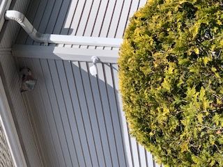

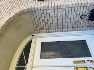

Don't know if my previous reply posted, but here is the pic of the cameras
Second pic

Thank you for the photos. If possible can you screenshot the live view from the Arlo app as well?
For the front door camera, I would suggest pointing the camera a little more downwards.
I have provided an article with information regarding optimal camera positioning. How do I position my Arlo wire-free camera?
