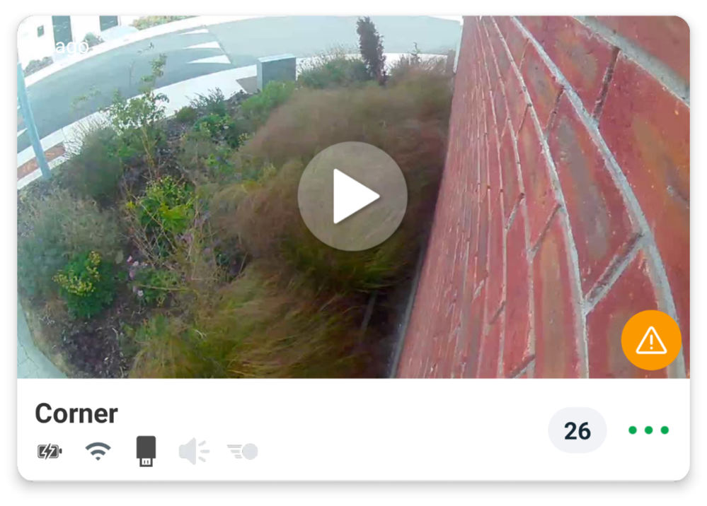

For about a week I've had this alert. On main and on guest. What is this about because system seems to be working and nothing was done to it.

Check your activity zone settings, we disabled ours and message disappeared.

If you have any activity zones set on your Arlo camera, it's letting you know that your activity zones is disabled until you connect your camera to AC power.

Disabled activity zones, took alert off.

I have 6 "Arlo Pro 2 cameras", from around 2 months ago 1 camera started daily (or even more than once per day) showing a yellow alert mark on the right bottom corner of the preview card, when I click on it, it says:
Create Activity Zones and get notified when activity happens within a defined space.
button 1: CREATE ACTIVITY ZONES
button 2: Not now
then when I click on Create Activity Zones, my zones are there, then I change them a bit so the SAVE button will get avaiable, I save the zones and the mentioned alert dissapear, but after no more than some hours, this alert comes back.

On each camera click device settting... 7 item down is activity zones. If its enabled click disable
