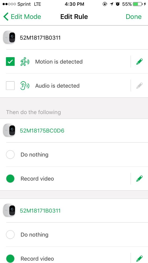

Problem #2: I have one camera setup that when motion is detected, it triggers recording on another camera as well as records on the camera detecting the motion. Motion is detected, recording happens on the camera that detected the motion, but not the other camera. At all. Ever. When I go back into settings, it is still setup to record on that other camera (screenshot attached), so I know it is saving the setting, it just completely ignores it. The camera that is supposed to be triggered works on its own and records when motion is detected on it. How can I make camera #1 motion trigger camera#2 record?

Following this thread -- I'm having the same issue with a rule not triggering a secondary camera. It started this week.
In fact, I missed an important view of a car prowler last night because the second camera didn't trigger on the motion rule.
Has the triggering issue been resolved yet? I have three of my cameras set up so when they detect motion the other two should record. 90% of the time that doesn't happen. Only the camera that detected the motion is recording anything.

On Triggering issue, try changing each Cam's "Motion Sensitivity" differently..
Here's an Example:
Cam A Motion Sen = 100%
Cam B Motion Sen = 99%
Cam C Motion Sen = 97%
and so on... the trick is don't make all of them the same..
And on your recording, make it fixed lenght.. Example:
Cam A triggers Cam B and C
Cam B triggers Cam A and C
Cam C triggers Cam A and B
Set Cam A to 60sec. and Set Cam B and C to 58sec..
Set Cam B to 55sec. and Set Cam A and C to 52sec..
Set Cam C to 50sec and Set Cam A and B to 48sec..
This way you know the point of origin where the trigger started when it comes out to your Library..
Hope you get the idea..
