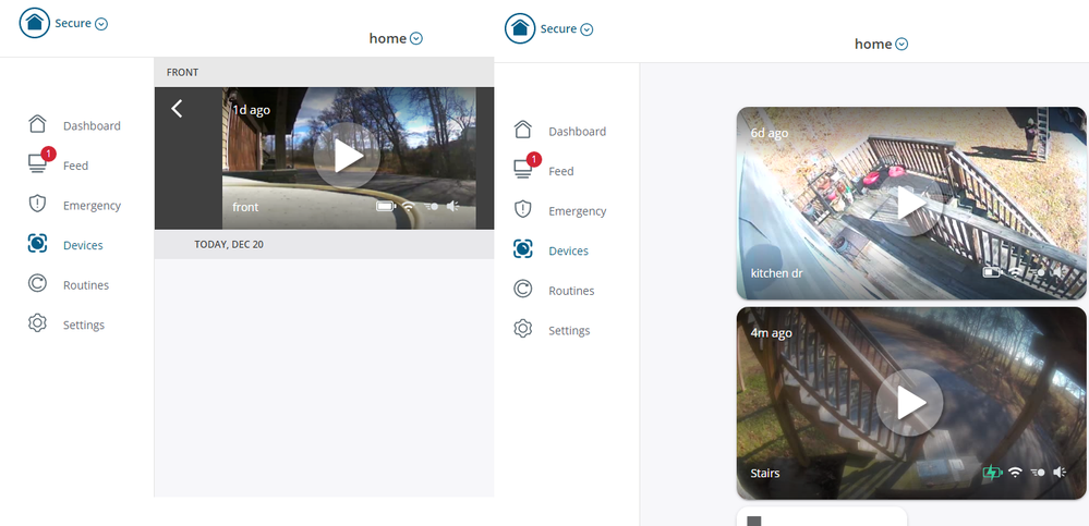

After setting up the Sec Hub and it seems like the Arlo App updated as well, how do I access my library like previously?
For one, on the app screen I no longer see if a camera has had any triggered events, it used to have a number in a circle to let you know if you had 0,1, or more events.
Also, I can't find once I click on a camera anything other than the CVR feed, there's no record of any past events nor any calendar view. Seems only option now is the Feed category where you see events from any and all devices in a continuous feed.
Sorry, couldn't edit my post above to include a pic.
I still get the number of videos not viewed yet on Android in the Devices view. You can click on that or go to Feed to view all of them.
Are you clicking on cameras in Devices or Dashboard? Use Devices - Dashboard just gives you another view but I don't think it works in the same way (I'm still learning myself). Also, you have to edit the 3 modes found in Routines to add cameras and actions. Any previous mode does not transfer so you have to build fresh. Click on the 3 dot menu top right to get a gear icon on each mode so you can edit them. You can also select Automations for scheduling and geofencing.
Ahh yes, on Android the # of events icon shows on the camera view, but not on desktop.
Also aware now about having to set new armed modes, which for now seems limited to 3 main options with no custom modes.
