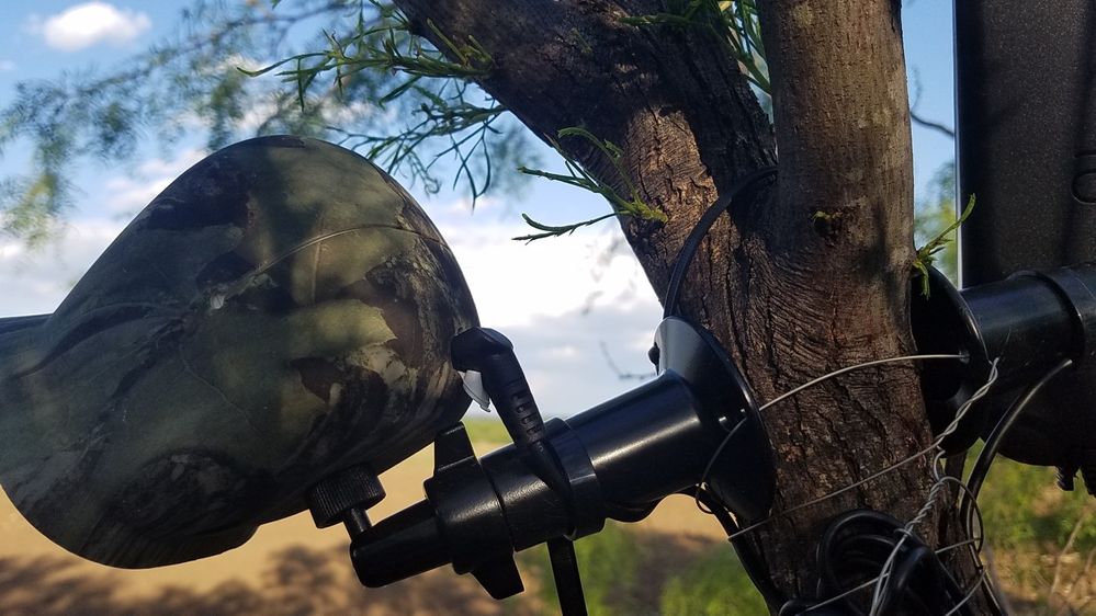

An update
after 15 days Netgear support guessed determined the solar panel is defective and is sending me a replacement, which has not yet shipped.
In my phone conversations with support, I requested that they send me the "wind bracket" that is included with the Arlo Go OUTDOOR power supply.  The reasoning is if the outdoor power cord includes a bracket that prevents the power cable from disconnecting from the camera, then WHY NOT INCLUDE THE WIND BRACKET WITH THE SOLAR PANEL?
The support agent was initially a brick wall and didn't understand my reasoning.  After repeating myself 10 times he finally agreed to put in a request to the warehouse if they could send me the brackets.  @JamesC This is what I mean by pulling teeth is easier than working with netgear support.
In the meantime:
  • I visited the installation on Friday.
  • Took pics of existing setup before any changes
  • Replaced the battery with a charged replacement
  • Replaced the solar panel with a new solar panel ( from ATT)
  • Added a new Arlo GO camera in the other end of the field
  • Moved the "defective" solar panel to the new camera location.
Observations:
  • The original camera is online with a new solar panel.
  • The original camera not reporting any solar panel errors with the new solar panel
  • The original camera since the replacement battery always shows "100%" charged, but never showing "charging". I'm suspicious.
  • The new camera, that now has the "defective" solar panel, is working fine.  The charge varies from 88% to 95%.  It shows that it is charging when there is enough sunlight. There are no error messages regarding the solar panel.
  • I am planning on returning to the camera on June 15th.  If there is a solar panel issue hopefully the batteries will last close to then.
Questions:
  • If the solar panel was "defective" for one camera, why is it not defective for another camera?
  • Why is the original camera ALWAYS showing 100% battery?  Even early in the morning its shows 100% before there is any sunlight for the solar panel to charge.
  • Why is the wind bracket not included with the solar panel?

The following is a repeat of above with pictures, maybe an additional comment:
An update
In the meantime:
  • Added a new Arlo GO camera in the other end of the field2018-05-26 08.00.57.jpg
Observations:
  • The original camera since the replacement battery always shows "100%" charged, but never showing "charging". I'm suspicious.  Since the battery was replaced, it has NEVER shown anything other than 100% 100% battery.png
Questions:
  • Why is the original camera ALWAYS showing 100% battery?  Even early in the morning its shows 100% before there is any sunlight for the solar panel to charge. battery 2.png

@MrsMay33 wrote:
jguerdat Guru:
Hence my above sentence saying, all cables fitted correctly and snuggly. I have changed them all and moved them around. It would not be the cables when literally one at a time in the matter of a few minutes all popped up with this message. I have 4 of them and all of them got the message. And now they are not working. This is a firmware issue I’m sure and it needs corrected!
I've replaced the camera, cable and the solar panel.  I've put dialectric grease in the plugs.  Same error.
Frustrating.
And more than 50% of the solar panel reviews on amazon have the same issue / error.
I feel like a $1,000 sucker.
