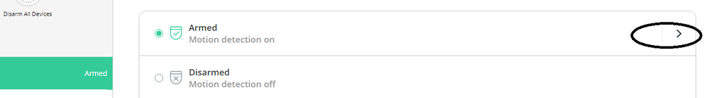

These are the steps for the "Library" experience. I'm doing this in the web ui (my.arlo.com), but they are very similar in the app.
1. Select mode.
2. Select the device (base or camera) in the left pane and then select the > next to the "Armed" mode
3. Edit the rule for the camera

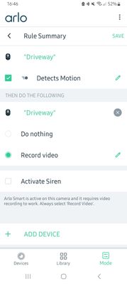

4. Select the > next to "Record Video"
5. Either select "record until activity stops", or set a fixed recording time using the slider.
