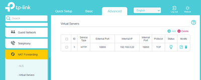

When I was using a TP-Link router with port forwarding I could see my Library outside my home network. Now with the Mesh routers with port forwarding set I can't see library remotely. Any ideas to fix this? Above is image from router, below is from Mesh Deco router setting that does not work remotely.

First thing to check is that the smarthub is still using 192.168.68.13. Also check that the port you need to forward is still 18866.
If you haven't reserved the IP address in the Deco, you should certainly to that. See page 34 of the manual (actually is page 37 in the PDF).
I'd also suggest using a custom service type (not http), and setting the protocol to "all".
Thanks, ip address is reserved. Have refreshed port several times and updated port in mesh router and used custom, still can't àaccess library external from home.
