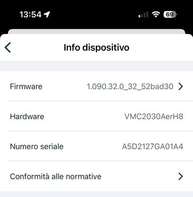

This is what I see in info device…
Anyway, else if the firmware release is the right one for my model camera, the problem remain… after this firmware update I cannot see the live video from Arlo app.. any advice in order to solve this behaviour?
