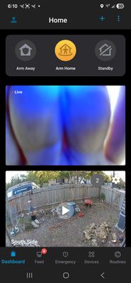

RichardTX
Multiple cameras. I just verified that if i cover the camera with my hand, it will start live streaming. I have pictures showing this if you would like to see them
Community Manager
Community Manager
Yes, that would be helpful. I have already escalated the details you've provided here. Any additional information we can provide to the dev team will help isolate the issue further.

Community Manager
Community Manager
Thank you for the screenshots.

RichardTX
The camera will say connecting and never connect if it is bright outside, but i can hear sound. As soon as it gets dark, or i cover the camera light sensor, the live stream will start working
