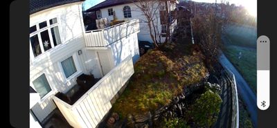

A screenshot of the light during the daytime may be useful so we can see how it's aimed.
Based on your pictures, it appears that you may be able to move the camera to the left (as viewed in the pictures) since it seems that there is a corner of the building that may prove to be a useful mounting location. A picture of the building/corner may also be useful for suggestions.
Attached are a daylight picture, as well as a picture of the house. You can see my old reolink camera on the house. The Arlo Essential XL is in the same place. I didn't have problems with night vision on the Reolink. But the battery life was abysmal.
I wasn't expecting to see that sort of light - I figured it would be a floodlight. That makes a big difference.
I can't say that I see a resolution to the issue other than moving the camera more or less into the corner of the house to help remove the light from interfering with the view.
