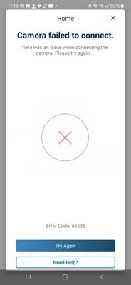

I have a 2nd Generation Essential Camera and a VMB 4000 base station. My firmware has been updated so the camera will work on my base station but guess what? It still does not work. When I go into the app and choose Hub/Base station it finds my VMB4000 but will not connect the camera. It says Camera failed to connect and it sitting right here in sync mode. Also tells me Error Code 65535. Now if I try to connect it to wifi it will find it easy and work. I want it connected to my base station!

Which version of the mobile app are you using (iOS/Android)?
Are you able to provide a screenshot of the 65535 error?

App says 5.05_28754 and here is what it does every time I try to add the camera.

kb9hgi,
I've opened and escalated a ticket detailing what you've mentioned here. I will provide an update once I have more information available to share.
