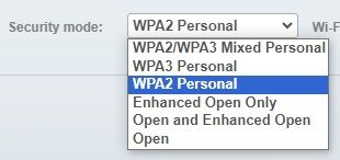

Is the security set to WPA2 (AES)?
FWIW, the easiest path is to set up the new router's network name/password to match the old one. Then you don't need to re-onboard the camera (and all your other devices will just connect).
The security is set to WPA2 Personal, which is the only WPA2 option.

Does it connect if you switch to wpa2/wpa3 mixed? (leaving the network name/password alone)?
Thanks for the reply.
It still cannot connect, given that I did not change the wifi name and password.

After switching to WPA3/WPA2 mixed then back to WPA2 secutiry for Wi-Fi, the camera was once able to connect. However, suddenly it disconnected from the Wi-Fi and it keeps Offline under the device list.
I removed the camera from the device list, but it cannot connect to the wifi anymore. I tried switching the security setting of the wifi to wpa3/wpa2 mixed mode then back to wpa2, but this trick did not work anymore.
