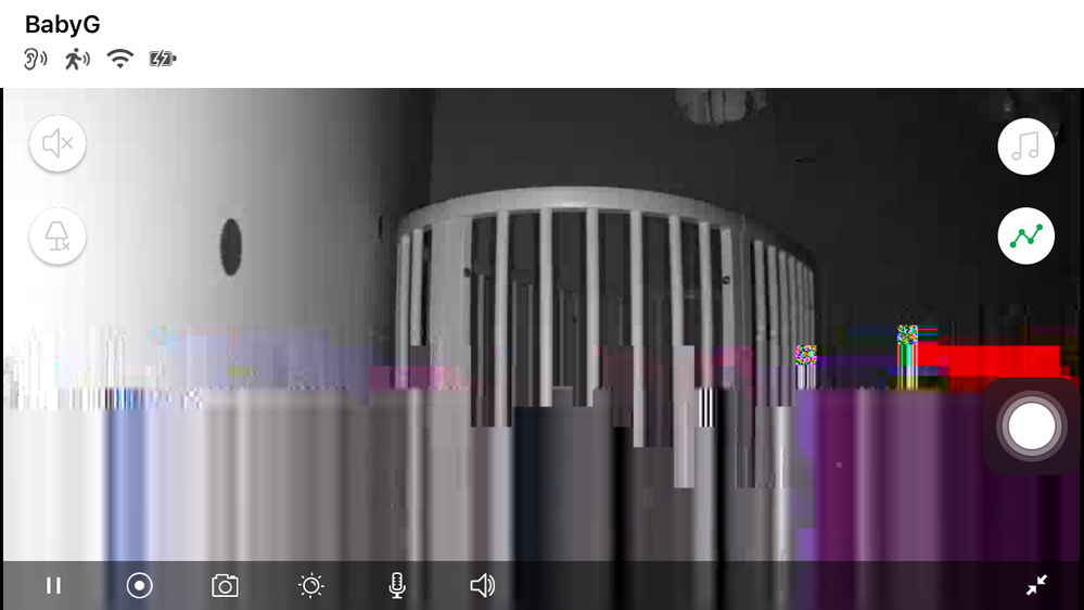

Can someone reach out to me about the same issue I have included pics below
stevopike,
This could be an issue with WiFi interference or poor signal strength due to range. If you move the camera closer to your router, do you get the same results?
Do you see any difference in behavior if you connect the camera to 2.4GHz (or 5GHz if you are already connected to 2.4GHz)?
Also take a look here as you could be experiencing this issue: Arlo Baby with AT&T U-verse Router
dont think proximity is it, I have an orbi router and it is on the other side of the wall from the camera, actually it only happens on my phone, does not happen when i do it through the laptop.
And I don't know if the orbi has a way to select the 2.4 or 5, does it?
stevopike,
I will reach out to you in a private message to gather more information and open a support case on this issue.
