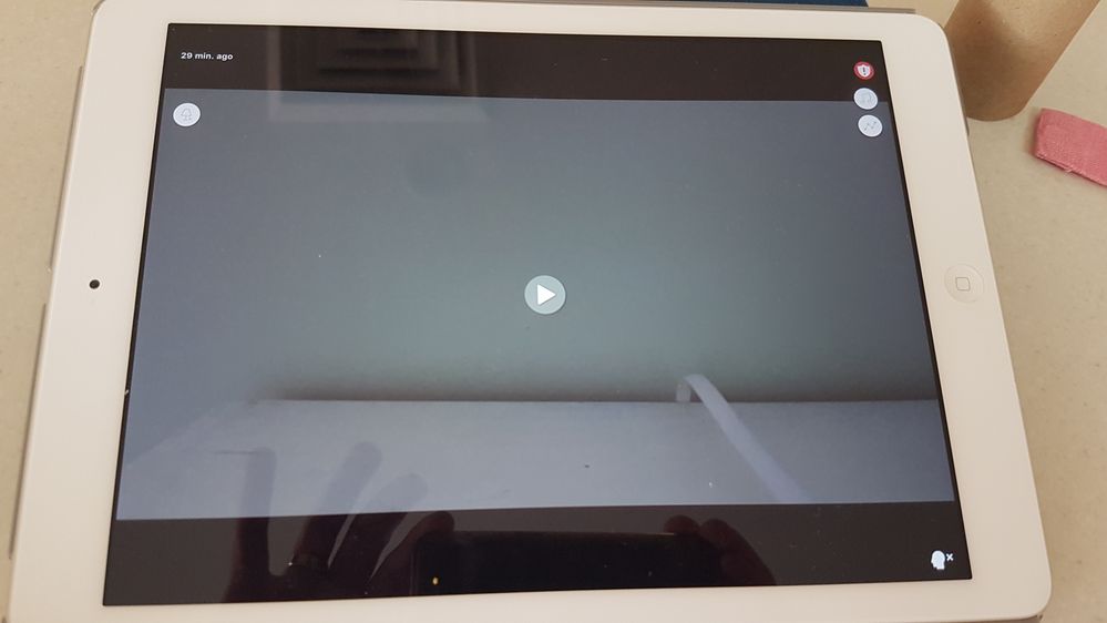

See below image for how screen looks after stop. While running the icon in the top left says Live (with a red dot). In many chats you talk about wifi/home, the Arlo Baby has never shown that in the top left when on. Please out a photo up of what you are mentioning.

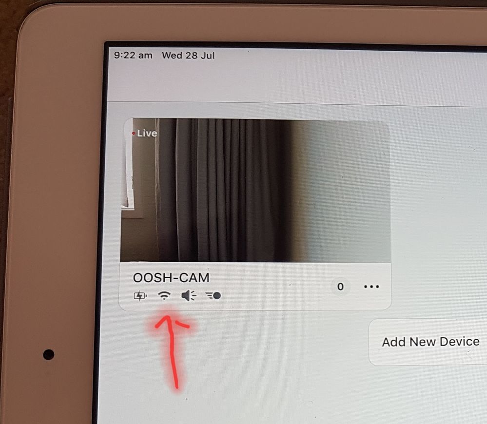

Or are you talking about the wifi icon just under the display? See below photo for what I am talking about.
YOU need to add a photo to show what you are talking about, it would make what you are talking about easier to understand when clearly people aren't seeing anything but what we send you. Text messages is clearly not helping people give you information.
This is what the icon looks like when successfully connected to the local network/Local live streaming. If you do not see this after 1-2 live stream (Play button) presses, you may want to try & reboot or factory reset the baby camera. Please make sure to connect to the same network as your phone. You can find more info here: How can I reduce video streaming lag or delays when viewing my Arlo Baby camera?
I have verified that tis feature is working and can not replicate your issue. This was a recent screenshot from my test. Please contact the Support Team to further investigate this issue. You will find several options for contacting support in the provided link. Arlo Tech Support
