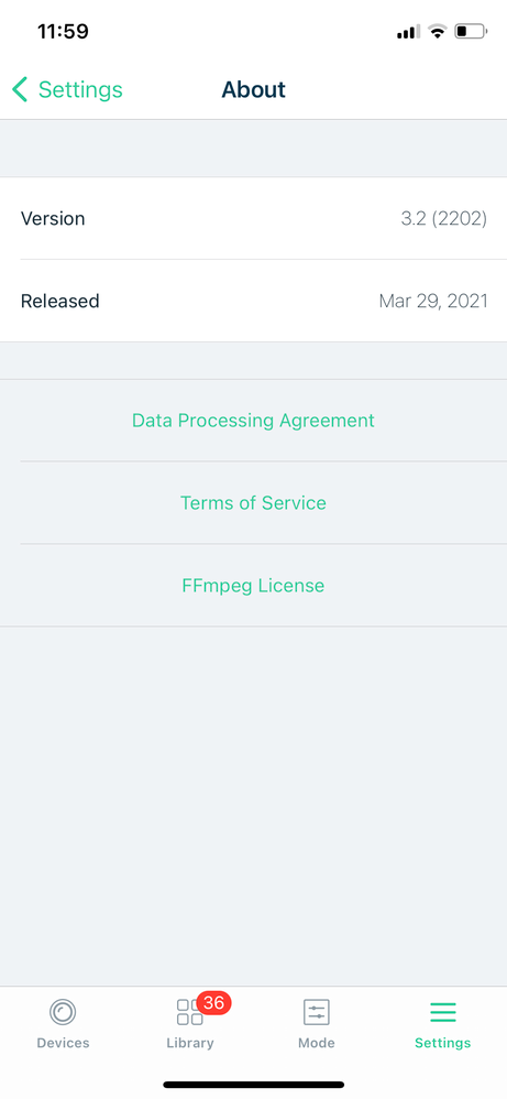

Can you try removing/re-installing the Arlo app and verify you are running version 3.2.
