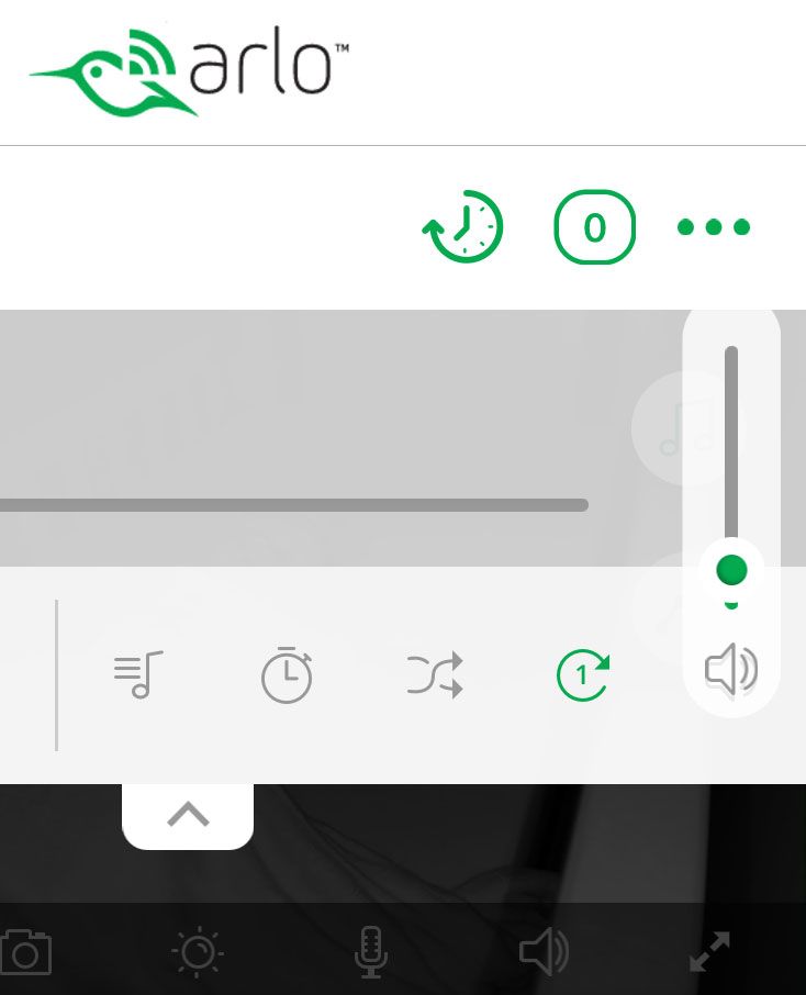

A few issues:
1. The volume control for the Speaker under Audio Settings - Speaker Volume within the iOS app doesn't actually update the volume. Push to Talk remains at a default loud volume despite the setting's value.
Does anyone have a workaround for this?
2. The vertical volume control slider for the Music is functional but tedious to use because the slider is so small, the hit area is basically the size of your finger/thumb, which makes the precision a nightmare to use. Try setting it to 5% volume. It's damn near impossible. Please redesign this to use a significantly larger vertical slider, or alternatively use a horizontal slider which fills the screen width.
