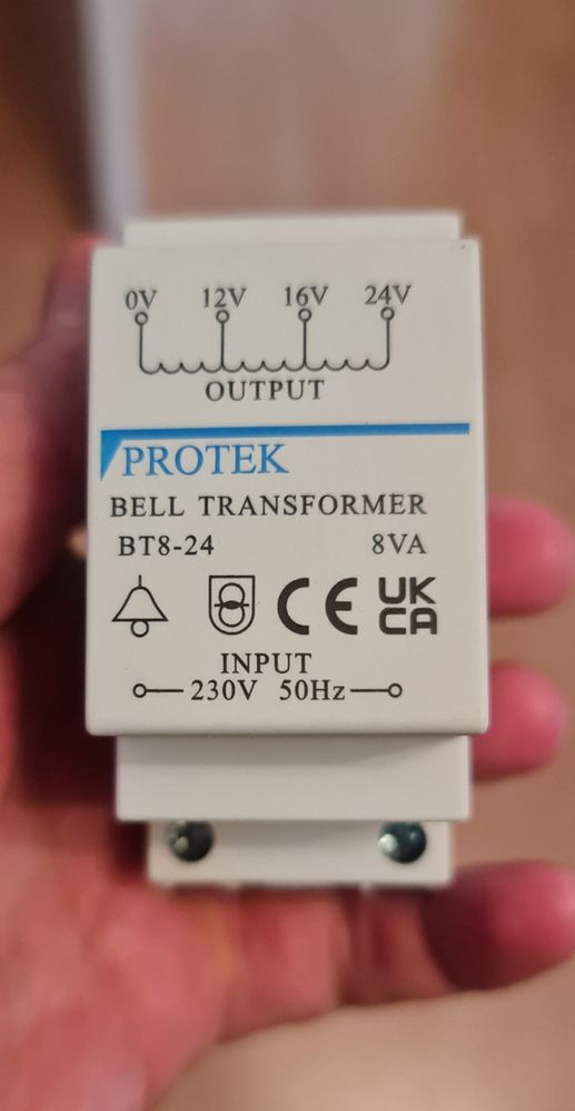

I am getting my replacement transformer as the one that came with my Arlo wired doorbell is faulty.
In the meantime i am having to source a new chime as my one is too old and doesn't have the power needed and would likely melt upon use 😆
I cannot find any chime that is between 8 volts and 24 volts as they only go up to 16V
FWIW, a mechanical chime is only drawing power for the brief time it is ringing, and the circuitry is very basic. So it likely is safe to use a 24v transformer with a 16v mechanical chime. A digital chime has very different electronics, so don't go over the voltage spec with those.
But the AVD1001 needs a transformer between 16-24 volts. So 16 volts should be ok as a replacement, unless you have a lot of loss in the wiring.
You could also exchange it for the AVD2001 "wire free" model. It has a battery which is trickle-charged from the wiring, so it can be used with a wider range of voltages/power. It will work with an 8 volt transformer.

I have a feeling of dread that this simply is not going to work and I will have to return it but at least it is simply because of a lack of compatible chimes and not because of my electrics in the house that was first thought when the transformer started to loudly buzz.
