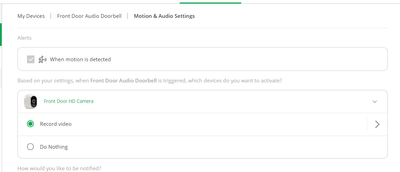

In my understanding, the recording length is fixed with the Audio Doorbell triggering it from motion. This is certinly different from the Arlo Q/Arlo Q Plus (which can stop recording if motion stops), not sure how the base station linked wireless cams handle it however in general (fixed length or once motion stops) without a linked doorbell. If only the HD Camera here does detect the motion, and this camera is paired to the Audoi Doorbell, we see the same fixed time length recordings as configured for the Audio Doorbell motion detection.
Check the Audio Doorbell recording settings in Devices -> Audio Doorbell -> Motion & Audio Settings -> Recording Settings
The max. recording time we configure is 120 seconds/2 minutes - so not sure from what does keep up the recording for five minutes, probably the camera and there might be an implicit max length of five minutes - wild guessing.

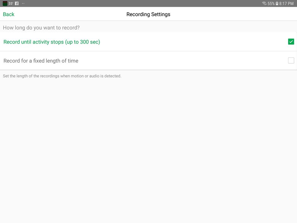

Motion detection from the doorbell can be set for either record until motion stops or for a fixed time. I use the fixed time since motion may stop.
Show us where - there is no such option "until motion stops" - only a slider for 10...120 seconds, Recording Settings does only show the "Recording Time" as in the screenshot above.

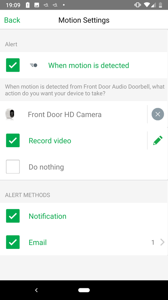

Android app.
Please click on thumbs up if this answer was useful - thank you!
Android App (v2.6.5._23400 on Android 9) - only time:
...or Web Client
@jguerdat Is this "Record until activity stop (max 300 seconds)" feature availability specific to the camera model (e.g. only on Arlo Pro and Arlo Pro 2, not on HD Camera), the Base station (e.g. not on the basic VMB3000)?
Mine happens to be a Pro camera on a Pro base but I don't believe that makes a difference. I don't have an original camera in operation so can't say for sure.
